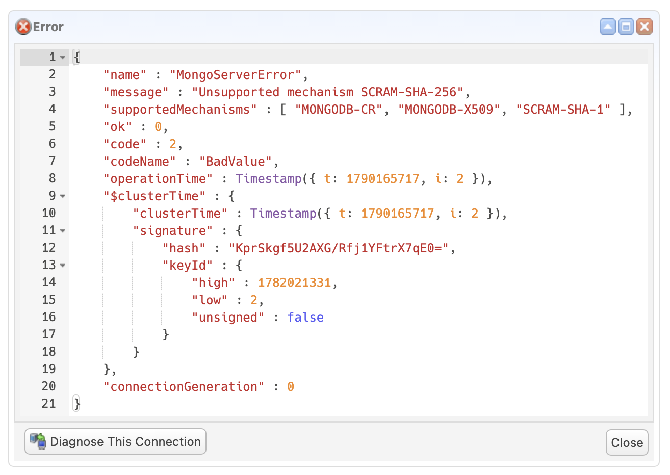

  2. A screenshot of the Test Connection window with the "Unsupported mechanism SCRAM-SHA-256" error visible.

2. Screenshot with the Unsupported mechanism SCRAM-SHA-256 error

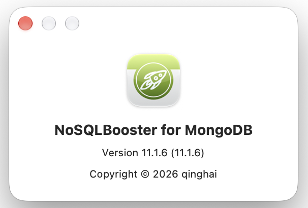

3. Help > About screenshot
